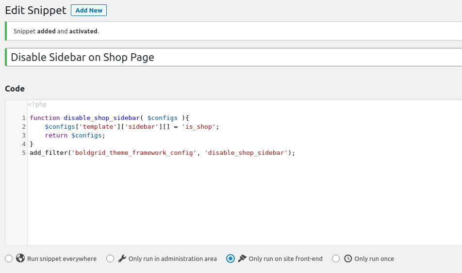

Using the Wedge Theme (or other BoldGrid Version 1 Themes), there is a way to accomplish this, but it does take a little bit of advanced work. Here’s how to do it:
- Install and activate the Code Snippets Plugin.
- Add a new snippet using the Snippets -> Add New menu item.
- Paste the following code into the new Snippet:
function disable_shop_sidebar( $configs ){ $configs['template']['sidebar'][] = 'is_shop'; return $configs; } add_filter('boldgrid_theme_framework_config', 'disable_shop_sidebar'); - Click the option for Only run on site front-end.
- Click Save Changes and Activate.
You should end up with a code snippet that looks exactly like this:
Once you’ve followed these steps carefully, your shop page will no longer have a sidebar. Please note that if there is any typo in the code snippet, it could cause a fatal error on your website, and you’ll need to enable Code Snippets Safe Mode to recover your site.
I hope this helps! If you have any trouble, please let us know, we’re happy to help.
