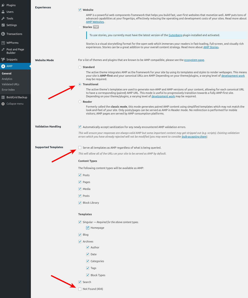

Thanks for the great question. At this time, we recommend running AMP in Website Mode -> Transitional mode to preserve the look and feel of your Cobalt website while serving accelerated mobile pages.
I suspect that switching to Transitional mode will fix your issue with your 404 pages as well, but if it doesn’t you might also try disabling the 404 template in your AMP settings:
