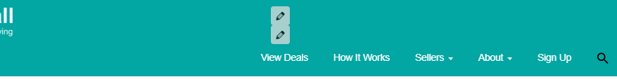

    Hi, I use WP boldgrid and Wedge theme. When I move my menu location from primary to Header Top Right location, the drop down menu items no longer display as they should. Instead every drop down menu item looks appears like another menu item. How to fix it
    Primary menu appearance:
    Primary menu location
    Header Upper Right appearance:
    Header Upper Right location
    I just want Primary menu to appear as Header Upper Right as is.

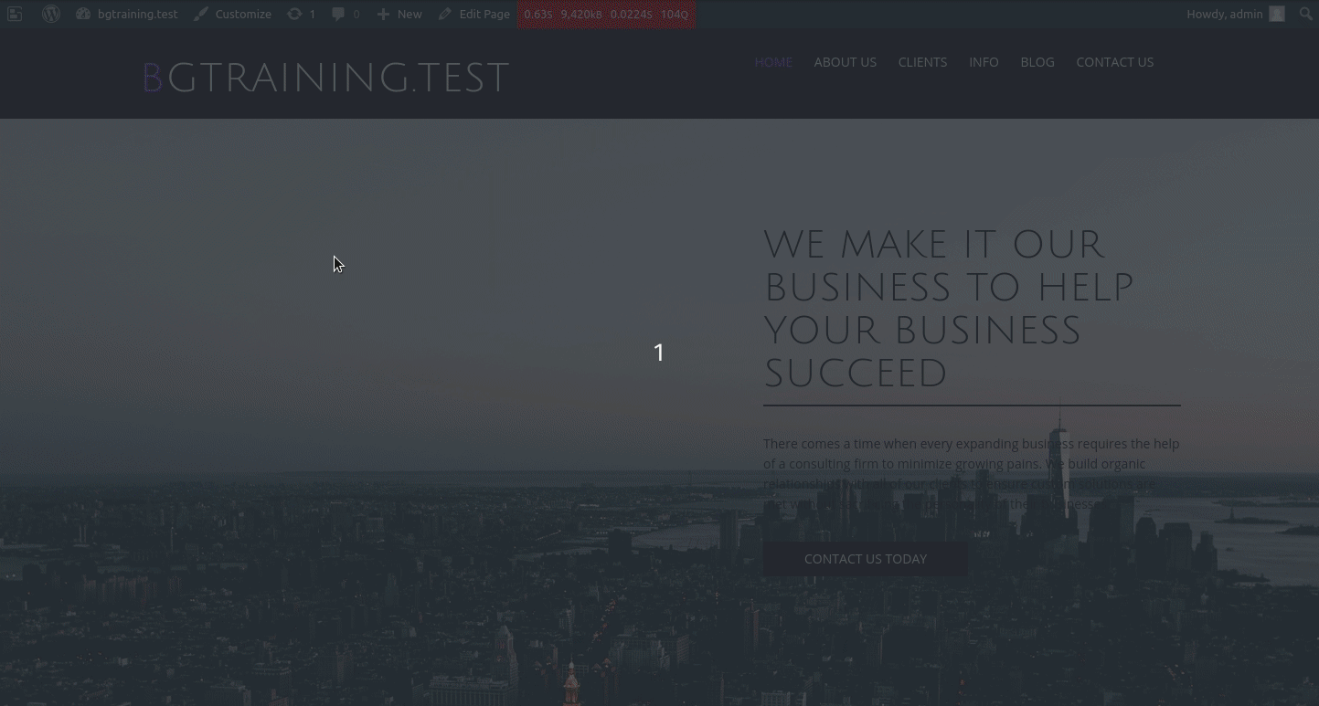

    If you choose to use Code Snippets, I’ve attached a file that you can import using the Code Snippets -> Import tool. I hope this helps!
    custom-theme-configs.code-snippets.json
    • This reply was modified 4 years, 12 months ago by Jesse Owens. Reason: add lightbox to gif

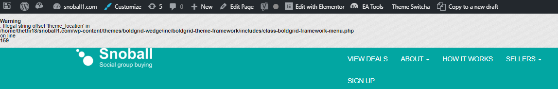

    Jesse: I saw this error, and menu wrapped around.
    primary menu wrapping to two lines
    #30491
    Hi Paul-
    The code I gave you shouldn’t have caused that warning to show up, at least it doesn’t when I try it out in a few testing environments. Either way, I recommend the following settings in your wp-config.php file to avoid displaying errors to your visitors:

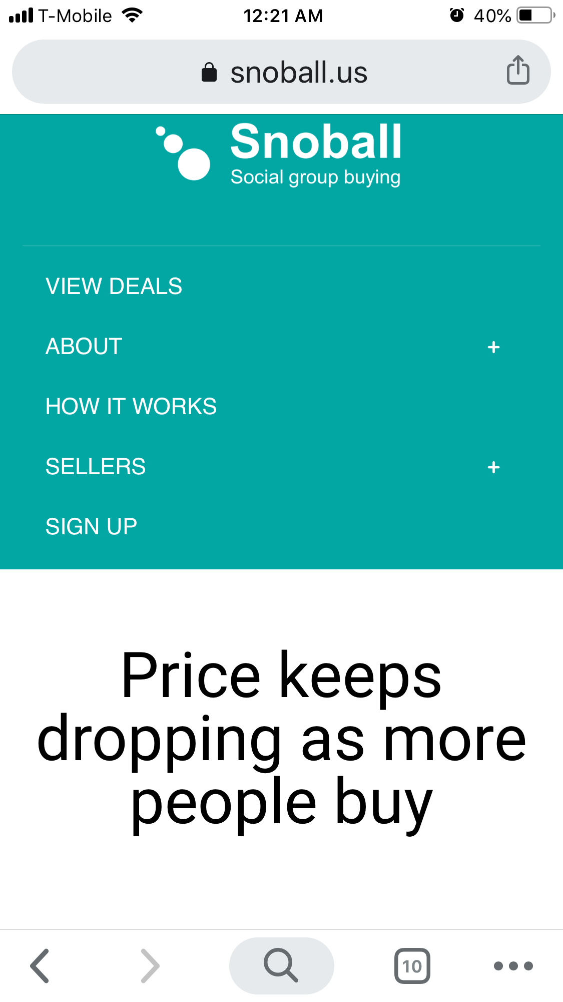

    Jesse: your fix works, but the display of the menu? It should be like that square box with lines inside right, instead of displaying the whole menu.
    mobile menu design
    #30493
    Hi Paul,
    Thanks for writing back. I consulted with the developers and they let me know I might have been going down the wrong path. You’re right that the JavaScript to turn the menu into the “Hamburger” (box with the lines in it) only works if we use the Primary Menu.
