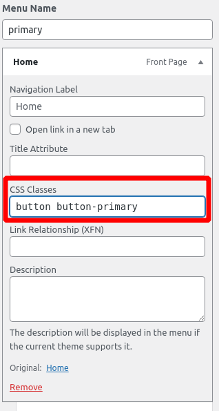

    In Evolv, you can use the “above header” menu position to add a call-to-action at the top-right with the CSS rules that Joseph provided above.
    You can even change a menu item into a button by adding a custom class to the menu item, button button-primary:
