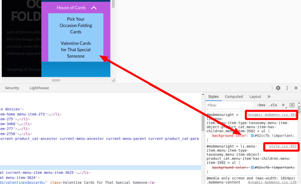

    #35754
    Hi Heather!
    Thanks for adding that!
    We can see now that there is indeed a rule that’s overriding your custom rule, coming from the Dynamic Mobmenu plugin itself. But, it’s exactly identical to your custom rule, so the effect is the same:
    While I don’t have a Samsung device on hand to test this out on a physical device, I also tried checking using the browserstack.com virtual device cloud, and the effect looks like it’s working as you’ve designed it:
    Are you seeing the same thing I am, and if so, are you trying to accomplish something else? If you’d like to include a screenshot, you can use a service like imgbb.com to share it here, or upload it to your own website’s media library and post a link to it there.
