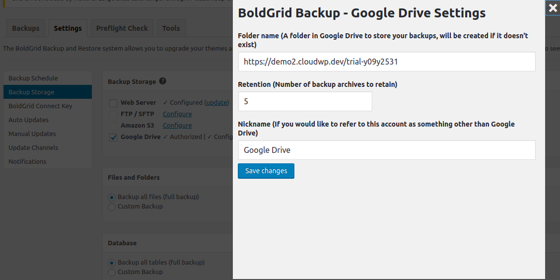

    I’m thinking your issue could have more to do with the allotted memory in your Google Drive itself. It looks like the backups are attempting to complete but are stalling out. You might want to go into your Google Drive and remove older backups or folders and files that are no longer needed.
    You can try decreasing the number of backups retained from the Total Upkeep ➡ Settings ➡ Backup Storage section of your WordPress dashboard under Google Drive > Configuration. This will only allow allow a specific number of backups to be saved in your Drive.

    I have had the settings adjusted to saving only 1 copy of the backup in the google drive. Every backup overwrites the previous backup. I have 5 GB remaining on my drive space not including the space that will be freed up by the rewrite.
