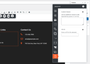

    As for the link styles. When you use the Advanced CSS tool you’ll actually be creating your own CSS selector and then using the selector you created in Customize<<CSS/JS Editor to change your link style. After selecting Advanced Controls scroll to the bottom and select Custom CSS Classes. You can name the selector whatever you’d like just make sure it’s not a class that’s already being used somewhere else in your theme.
    add custom class to boldgrid
