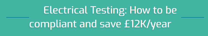

    We have a very similar issue with blog posts.
    blog post title screenshot
    This looks acceptable on a large screen, but not on a phone sized device.
    There is an option in the Blog Posts editor to not display the header. This works in preview, but we cannot make it work outside the editor. We would in any case prefer to have headers, but get text normally wrapped and centered.
    How can we change this header format?

    Hello telecetera,
    Since it looks like this is the “Site Title” of your theme, you should be able to customize your site title and logo so it displays better on both devices. We are happy to help you troubleshoot further, but will need some additional information. Can you provide a link to your site for testing? What specific theme are you using?
