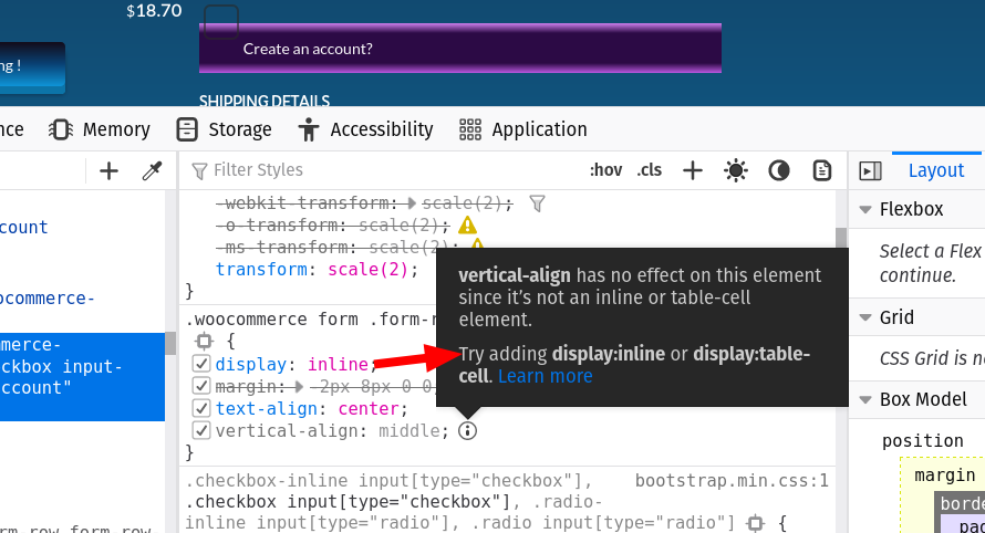

    That’s really a head-scratcher! It looks like this might even be a bug in Firefox itself, because you can see the Firefox Developer Tools conflicting with itself:
    While it’s true that the vertical-align: middle; rule only applies to inline elements, you can clearly see that this element is, in fact, inline.
    I did find a workaround, however, by changing the parent element to a block, which seems to work as expected in both Chrome and Firefox:
    .woocommerce form .form-row label.checkbox, .woocommerce-page form .form-row label.checkbox {
    	display: block !important;

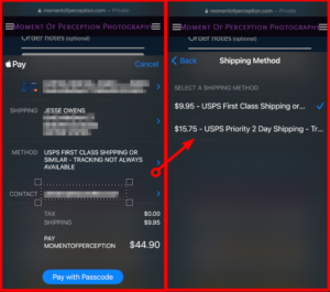

    2) This is something I don’t know if you can help with, but it’s another issue I sent to the Stripe folks and they are throwing back on the shipping plugin or the theme. I’m using the free version of Flexible Shipping by WP Desk, and it appears they only have support available for their paid version. The shipping is not being calculated with Google Pay, and I’m getting a ” Shipping Option Pending – Shipping Option cannot be calculated based on the current information. ” This is before and after the shipping address has been entered. Have you seen this happen before ?
    3) This last issue was also sent to Stripe, the credit card charge is being accepted with only a correct CC #. It is taking the charge with incorrect expiration date, security code, and billing address. I’ve changed the setting with Stripe to the max security settings, so this has to be occurring through the plugin, but they are not offering any solutions. I’m hoping you may have some thoughts on how to fix it.

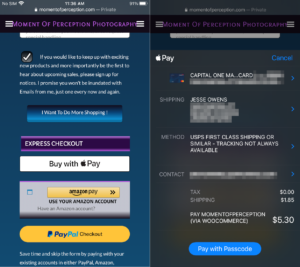

    You are amazing ! Thank you so much ! I sent the info you came up with on the Apple Pay issue to the tech, so hopefully, they can do the Unix Link you mentioned.
    The shipping for the notebook should be $ 5.75 for first class, and $ 8.75 for Priority, so it sounds like there’s a glitch there also. I’m lost on this as I don’t think I can get any help from the plugin developers, so I may be in trouble there.

    As far as the shipping, are you saying the Apple Pay is not giving you that Shipping Option Pending message that you see in the Google Pay screenshot I sent, and that you are able to change the shipping method in the Apple Pay window ?
    #38273
    Heather Spencer
    Hi Jesse,
    I need to ask that Apple Pay question better.
    If you are using Google Pay from a product page, you get that window and no way to add shipping or tax. If you use Google Pay from the checkout page, it picks up the shipping and tax from the page itself, but you still get that window that shows shipping not engaged, so you can’t pick what shipping you want from that window.
    Is that how the Apple Pay is working ?
    I really wish Apple would make this testable without having a touchless Apple device.

    #38411
    Hi Heather-
    You’re right- when I use Apple Pay it will pick up the shipping options *if I’ve set them* on the checkout page, but I can’t change it within the payment system.

    #39294
    Heather Spencer
    Hi Jesse,
    Hope all is well with you.
    I’m still working on the Google Pay/ Apple Pay issue, and have gotten tired of getting nowhere with the developers, so I tried a new plugin today which seems to work on both the laptop and desktop. Miracle !
    Can I trouble you to please check Apple Pay to see if it works properly for you both on the product page and checkout page ? Please don’t go through the checkout process, I just want to make sure that it’s picking up shipping and tax in both areas. I’m using a test site for this
    Jigsaw Puzzle – An Autumn Day in an Aspen Forest
    Now, related to that, when I tried to deactivate the original Stripe plugin, I got a fatal error. When I contacted my host techs they found this Error Message:
    Fatal error: Uncaught Error: Class “WC_Stripe_Payment_Request” not found in /home/moment72/staging.momentofperception.com/wp-content/themes/boldgrid-cobalt/functions.php:53 Stack trace: #0 /home/moment72/staging.momentofperception.com/wp-settings.php(525): include() #1 /home/moment72/staging.momentofperception.com/wp-config.php(84): require_once(‘/home/moment72/…’) #2 /home/moment72/staging.momentofperception.com/wp-load.php(37): require_once(‘/home/moment72/…’) #3 /home/moment72/staging.momentofperception.com/wp-admin/admin.php(34): require_once(‘/home/moment72/…’) #4 /home/moment72/staging.momentofperception.com/wp-admin/index.php(10): require_once(‘/home/moment72/…’) #5 {main} thrown in /home/moment72/staging.momentofperception.com/wp-content/themes/boldgrid-cobalt/functions.php on line 53
    There has been a critical error on this website. Please check your site admin email inbox for instructions.
    Can you help me sort that out ? I’m sure I’ll have the same problem with the live site.
    Thanks again,
    Heather
    #39299
    Hi Heather-
    Congratulations! It does look like it’s pulling in the shipping options, both on the product page and the cart.
